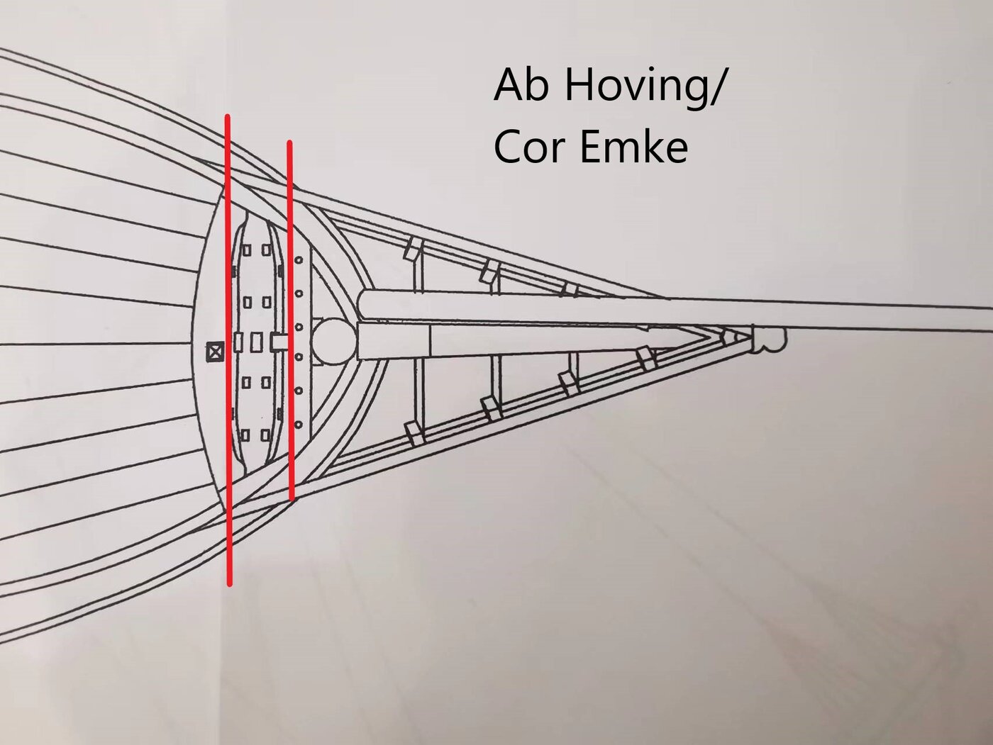

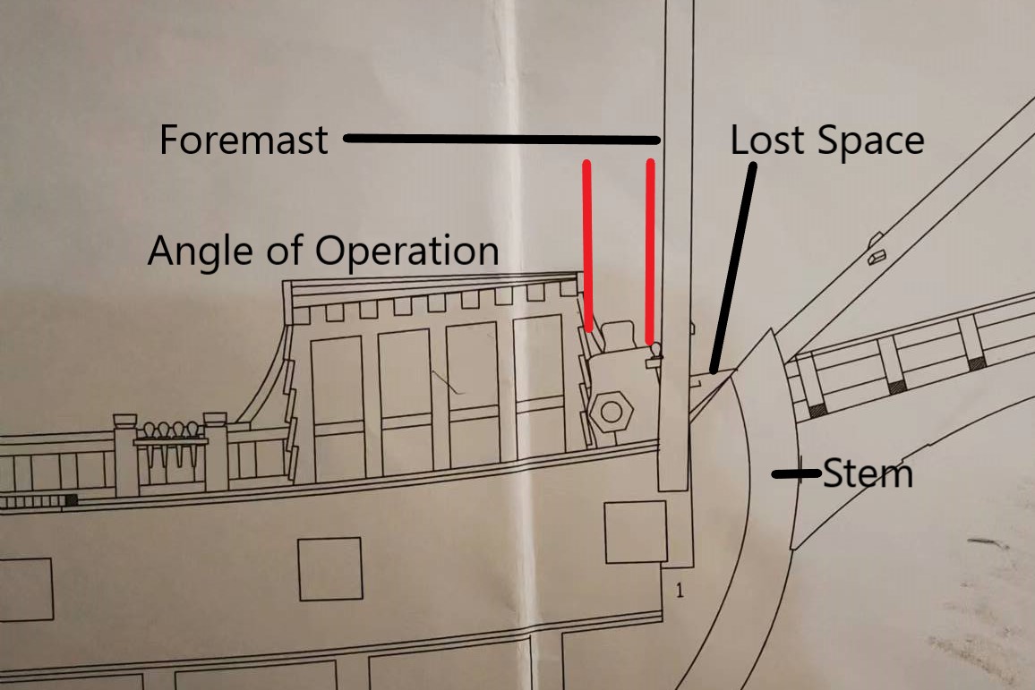

Eers de planne van Ab Hoving:

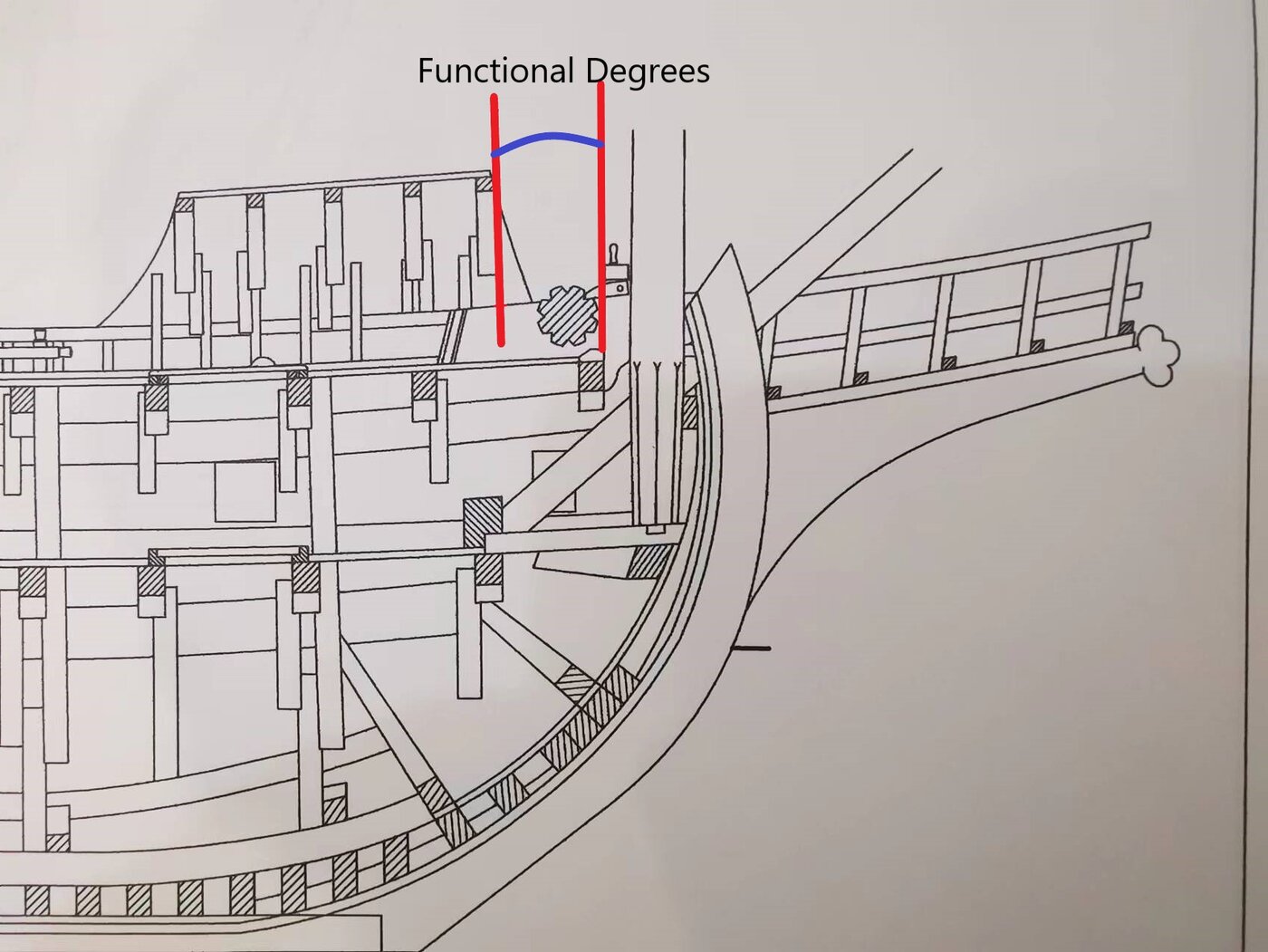

De rode lijnen dui aan de grade van beweging van de braedspit. Duidelijk is dit niet werkbaar op een rechte schip. Ik verduidelijk my rede waarom de Hoving en Kolderstok uitlecht niet kon werk as volg:
Ab's plans differ from Kolderstok's in the way that the foremast is right up against the stem. By doing this he gains a little more space than in the Kolderstok configuration. However, how on earth, would the crew have operated that windlass? What I call the functional degrees of operation is determined here by the roof of the canopy at the front and the height of the belaying pin rack. Even if the handspaken (ratchet poles) could theoretically extend beyond the foremast, their movement would still be severely impeded by the belaying rack mounted directly behind the foremast. Logic tells me this would not be possible.

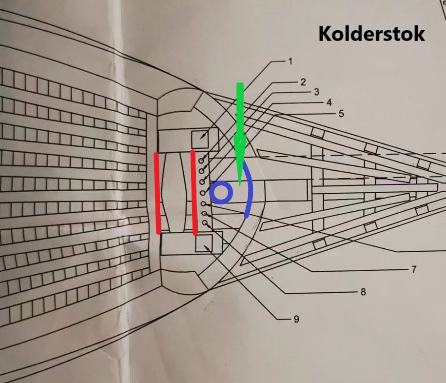

Now the Kolderstok Plans:
Because Hans does not place the foremast right up against the stem, the situation is even worse here, because now there is even less space. Once again the belaying rack and the roof of the front canopy serve as the factors determining the functional operation of the windlass. Not surprisingly, the angle of operation is even smaller than in Ab's layout.
The green arrow points to the space that is lost because the foremast does not butt up against the stem.

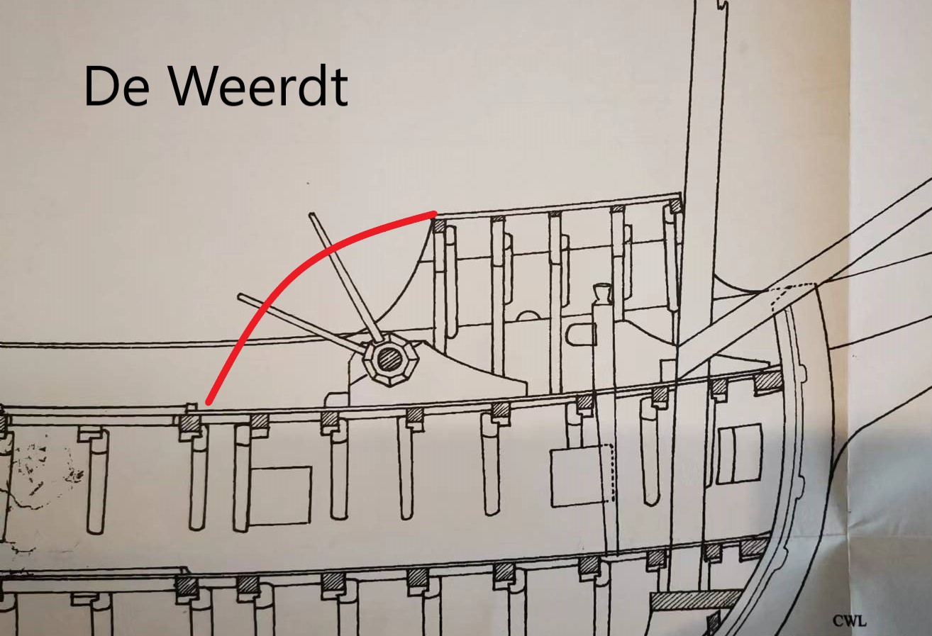

Now let's look at De Weerdt's configuration:
It's a no-brainer. Here the windlass can operate unimpeded and in the way that it was intended. So, purely in terms of functionality, there can be no doubt as to which is the most preferable option.

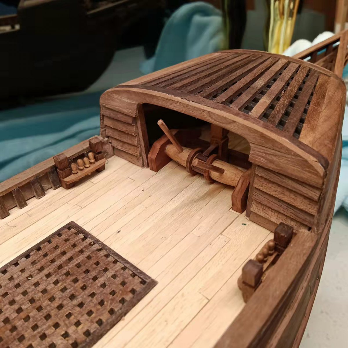

Verder,

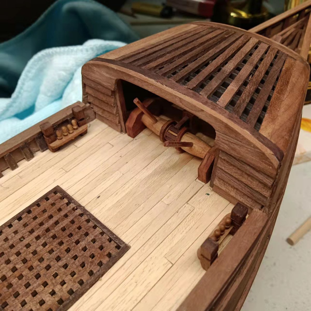

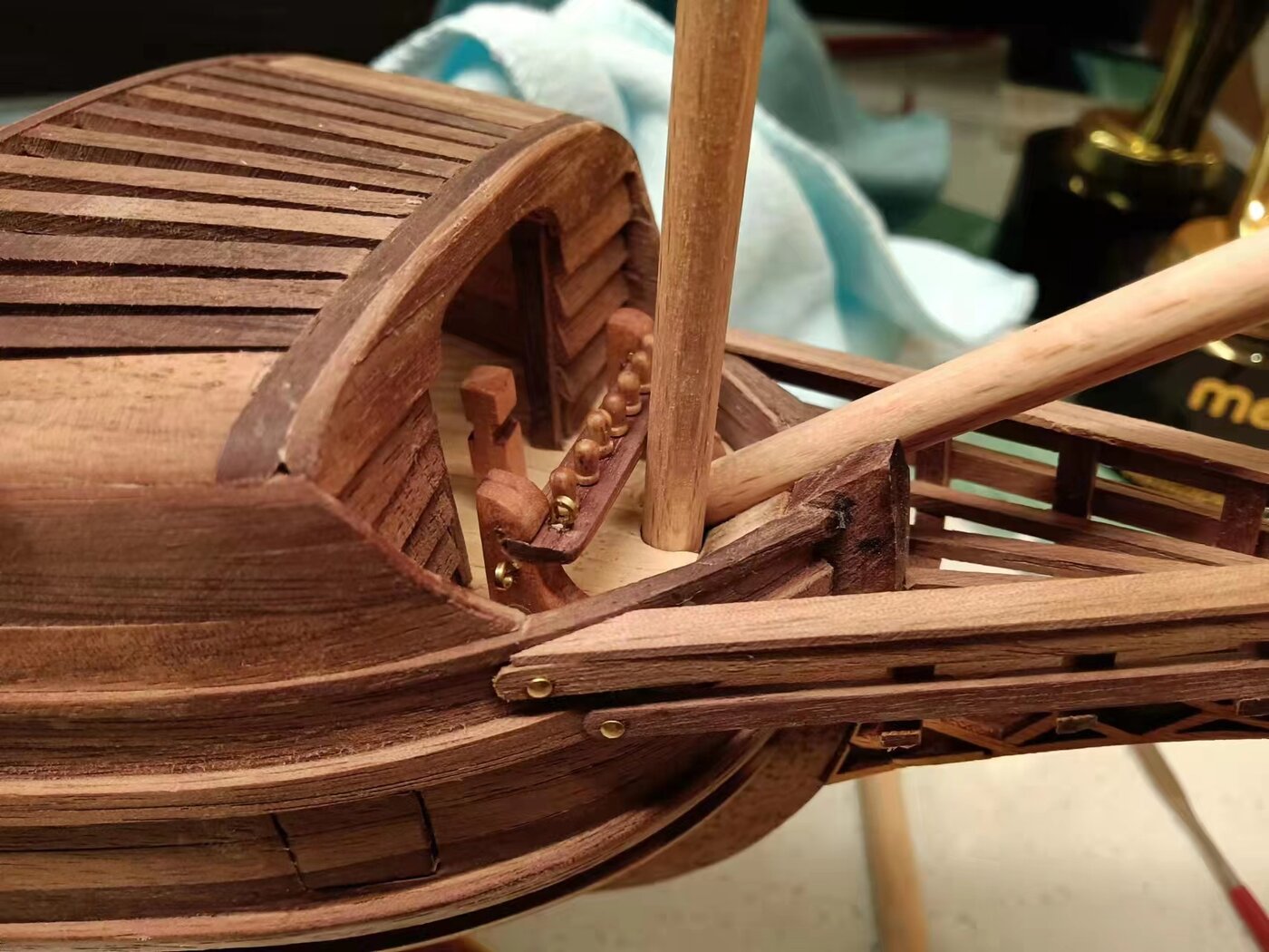

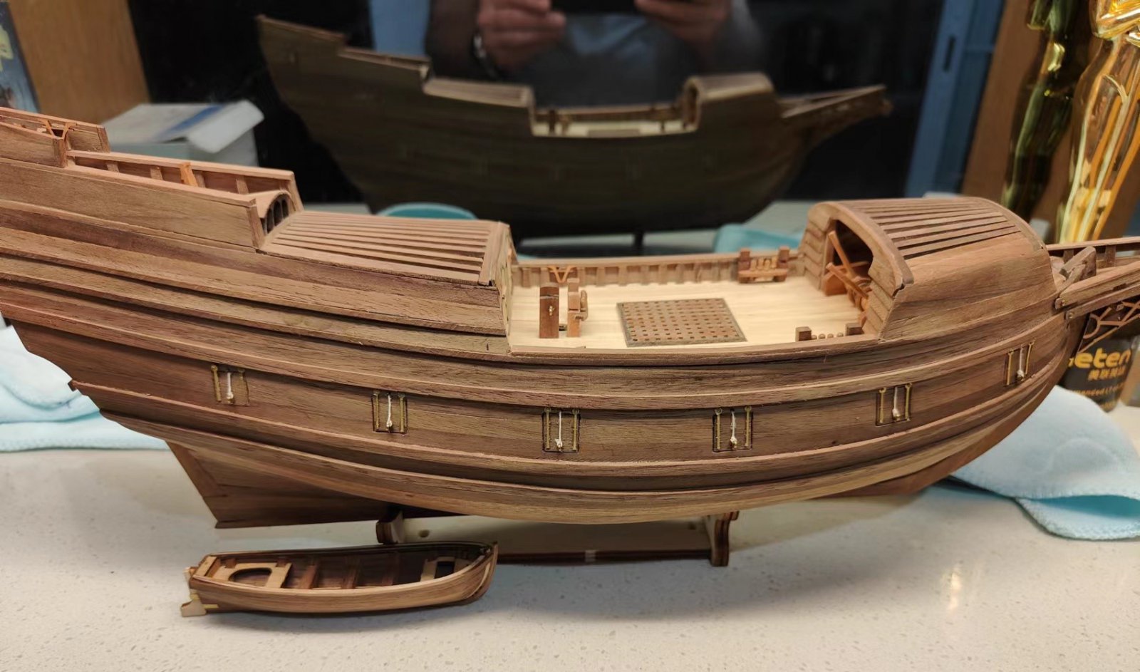

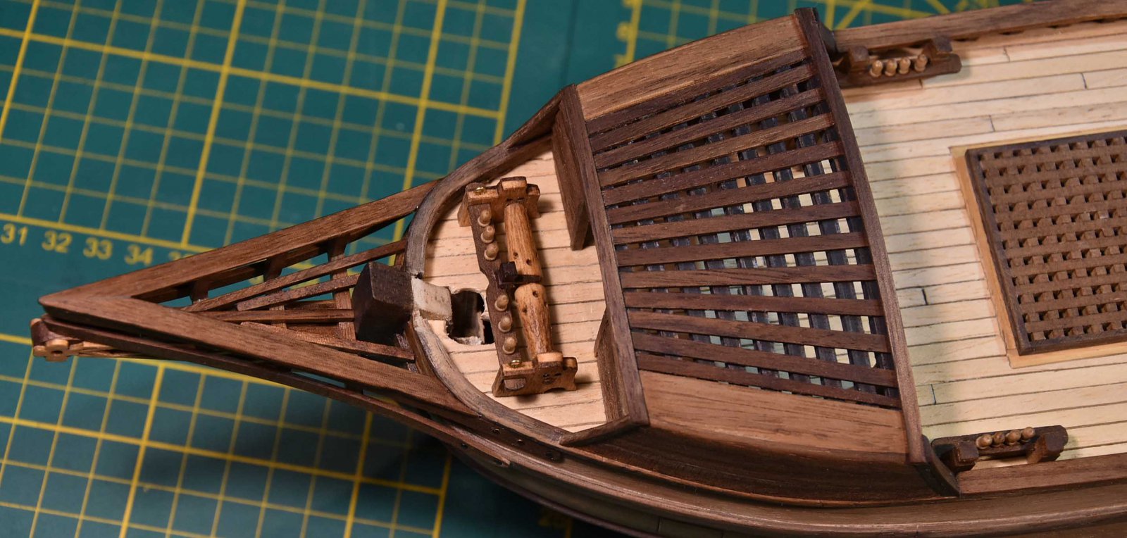

In de boeg is dus net de nagelbank geplaats en een knecht daarachter. Hier wijk ik dus heeltemal af van Kolderstok se planne en ook van Piet se bouw.
De voorstewe is nou mooi schoon en daar is werksruimte.
De gleuf vir de boegspriet is uitgevijld.

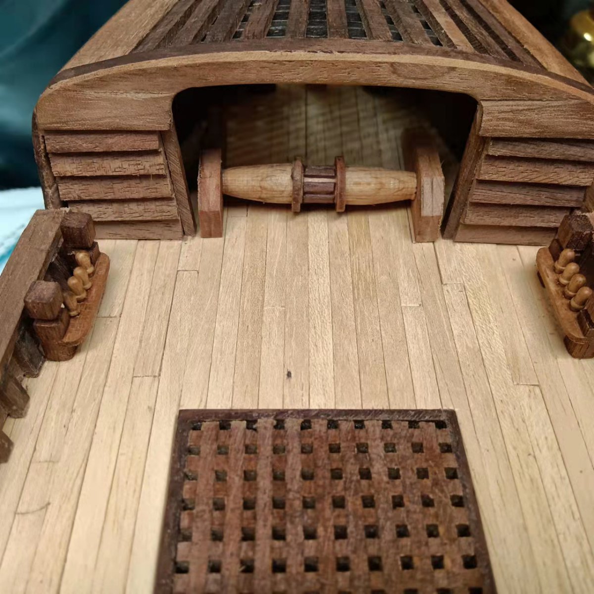

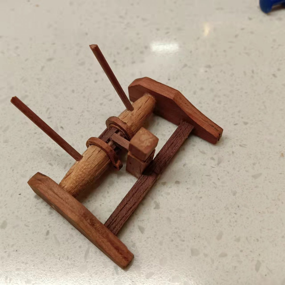

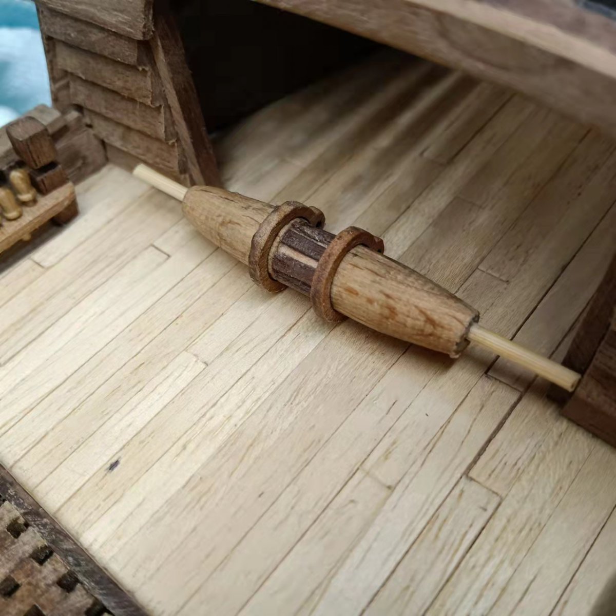

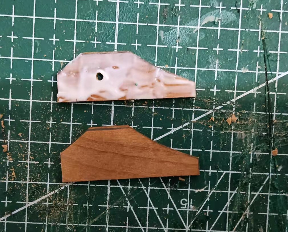

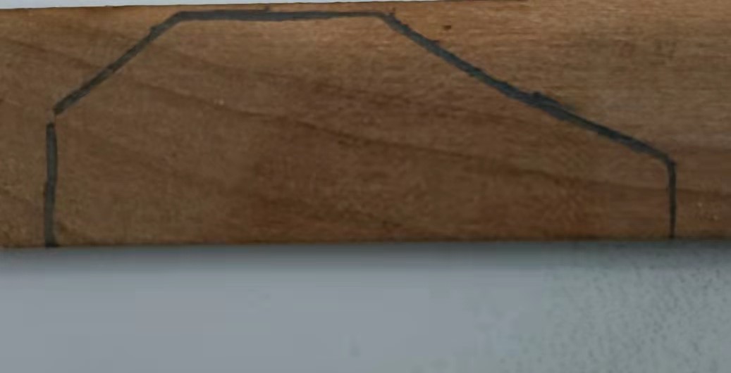

En toe heb ik een begin gemaak met de braedspit.

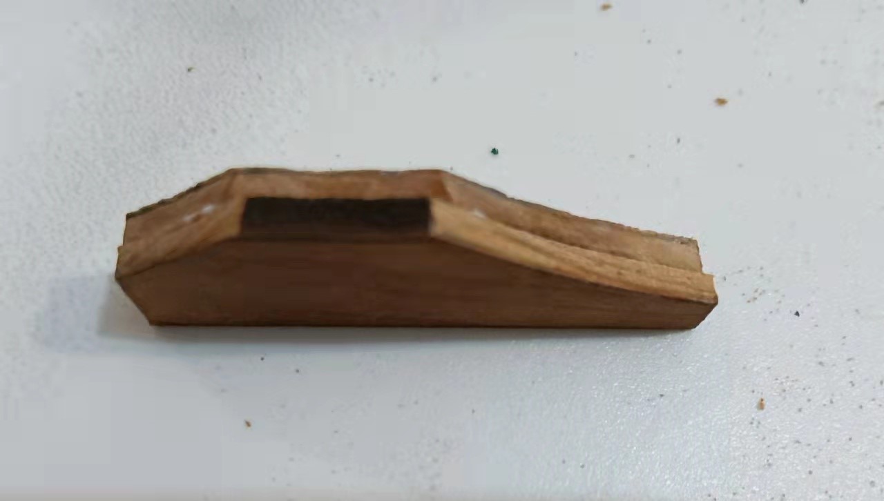

De twee helftes wat meet een X-Acto uitgesnij is, aanmekaar verlijmd.
Daarna was dir de beurt van een vijl en schuurpapier om de vorm mooi te maak.

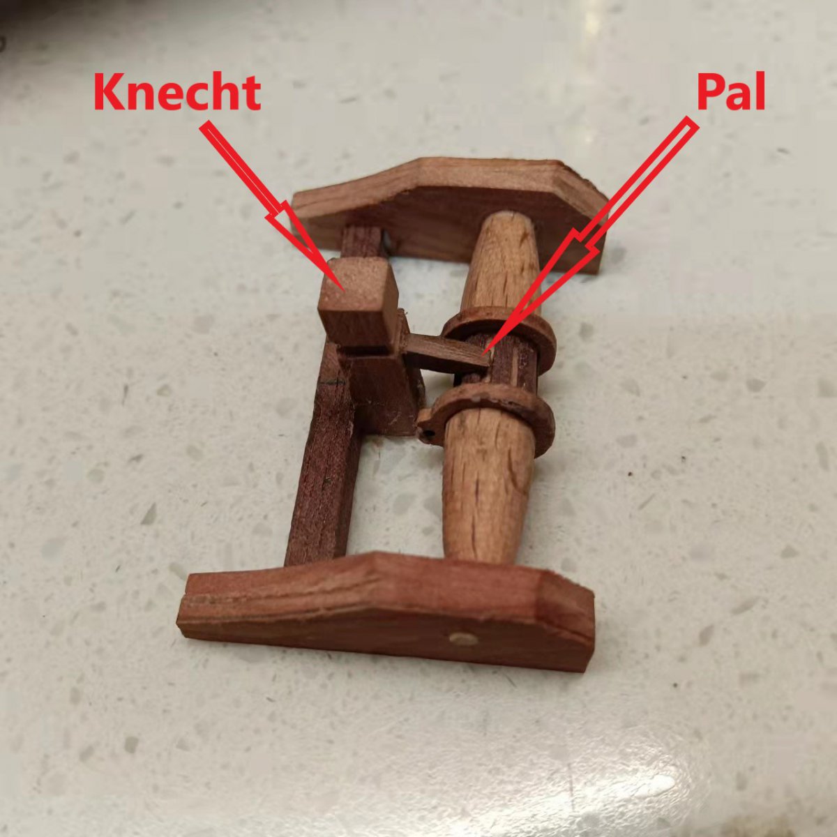

Dry-fit

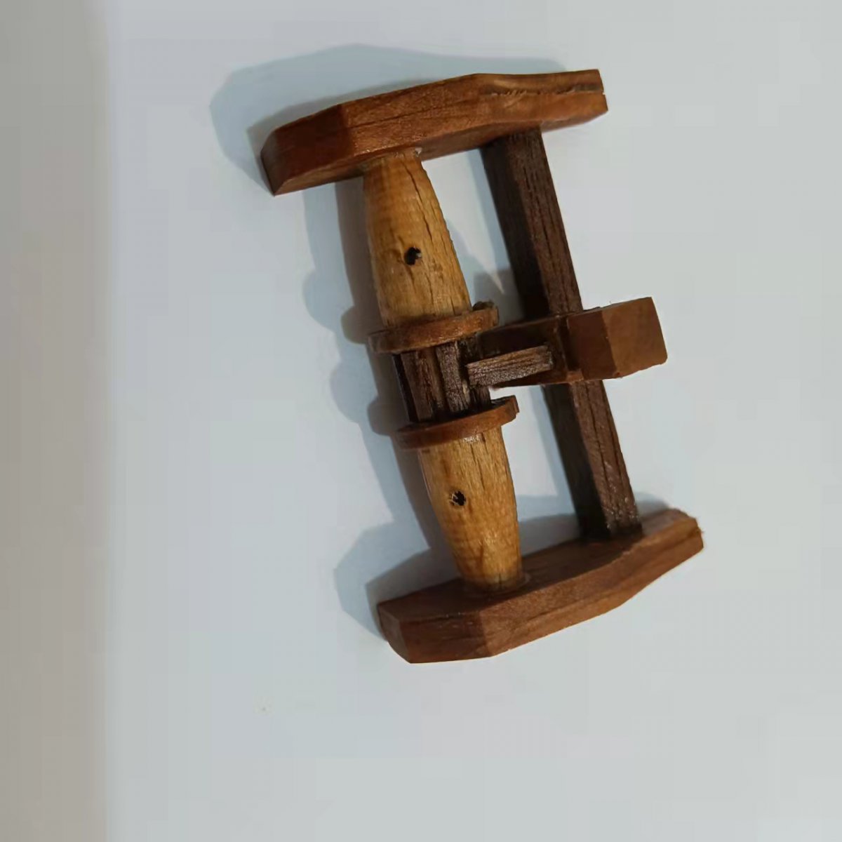

En laastens is de knecht en pal bijgevoegd om een geheel te maakt.

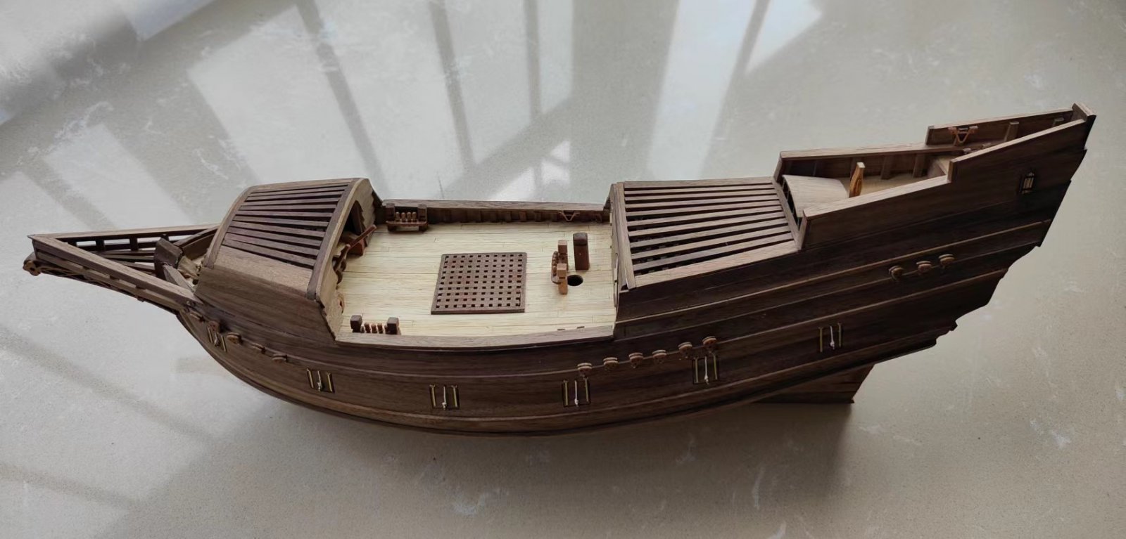

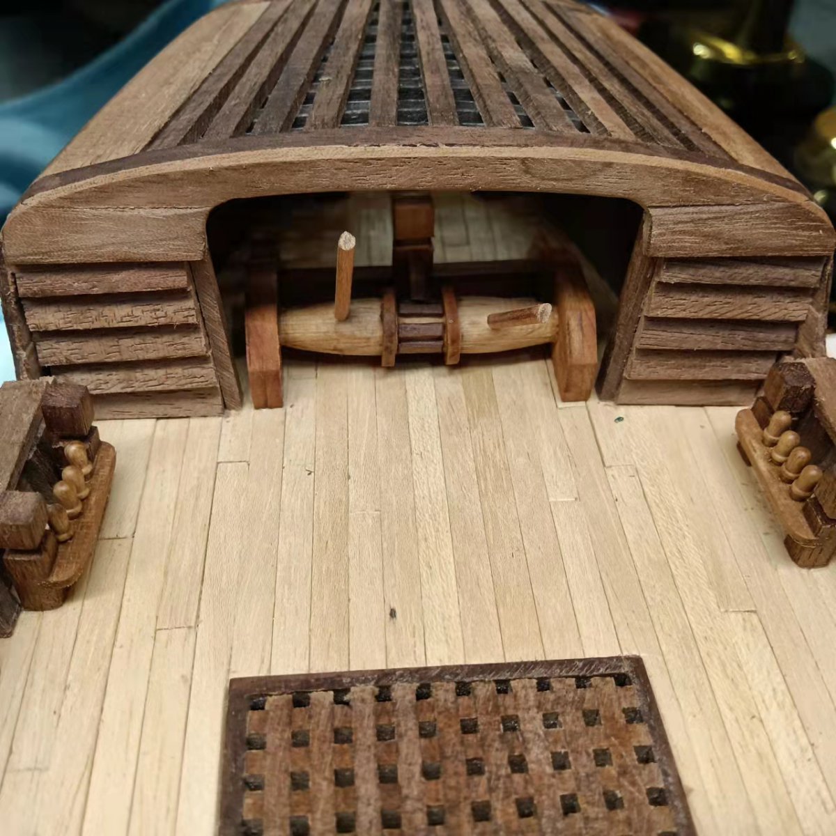

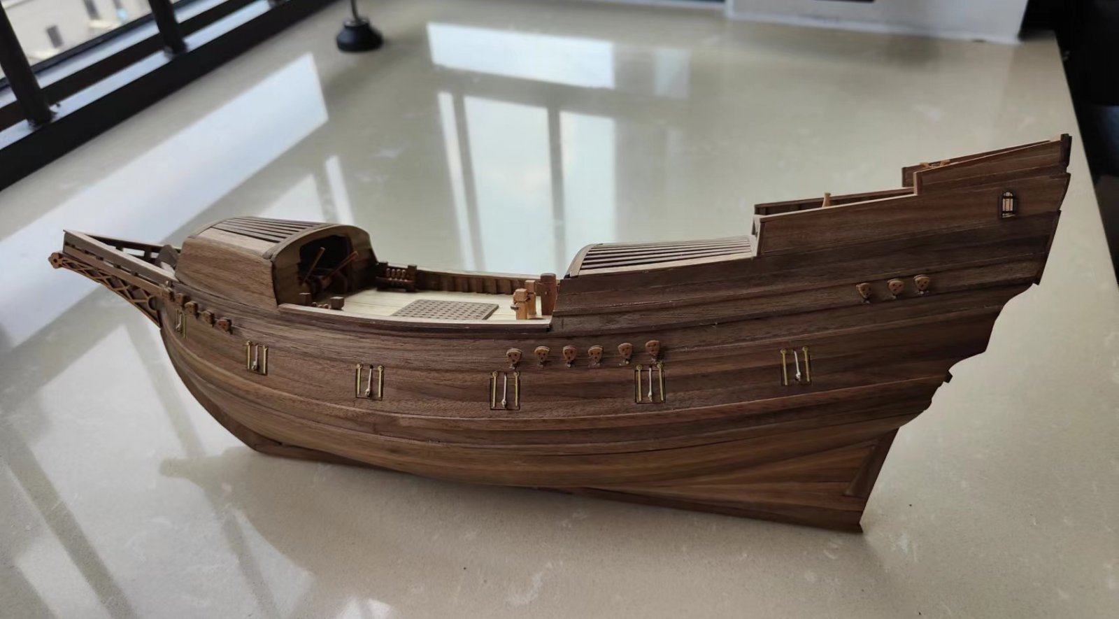

Prachtig werk weer Heinrich :thumbsup: en je uitgebreide onderzoek over het schip van Barentsz is mooi om te volgen. Zelf heb ik de braadspil geplaatst zoals beschreven en getoond in de plannen van Kolderstok, maar dat weet je uiteraard al. Ik heb om toch wat ruimte te creëren simpelweg de spil wat kleiner gemaakt en de sluitklampen smaller geschuurd zodat de spil toch redelijk achter de voormast past en er ook nog wat ruimte is tussen de opbouw en de ankerspil. Ook is de boeg van mijn model iets breder als dat van jou,
Dus voor mij komt je onderzoek iets te laat, wat natuurlijk niet erg is, want het is en blijft een hele kunst om een model precies en accuraat uit te voeren zoals het er vroeger uitzag ;)

Vele dank vir de mooi woorde Piet. Jouw windlass ziet daar prachtig uit, maar bij mij was de ruimte net te knap om dit te maakt werk. En zoals jij zeg, de research het mij ontsettend baie geleer.

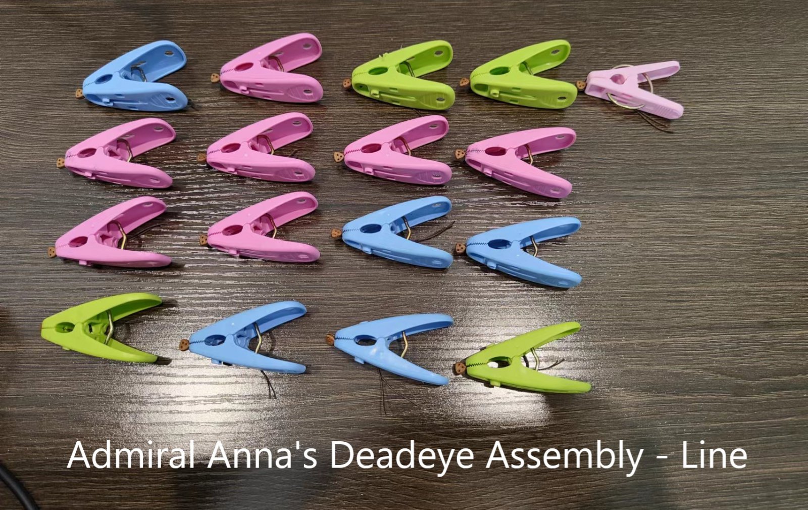

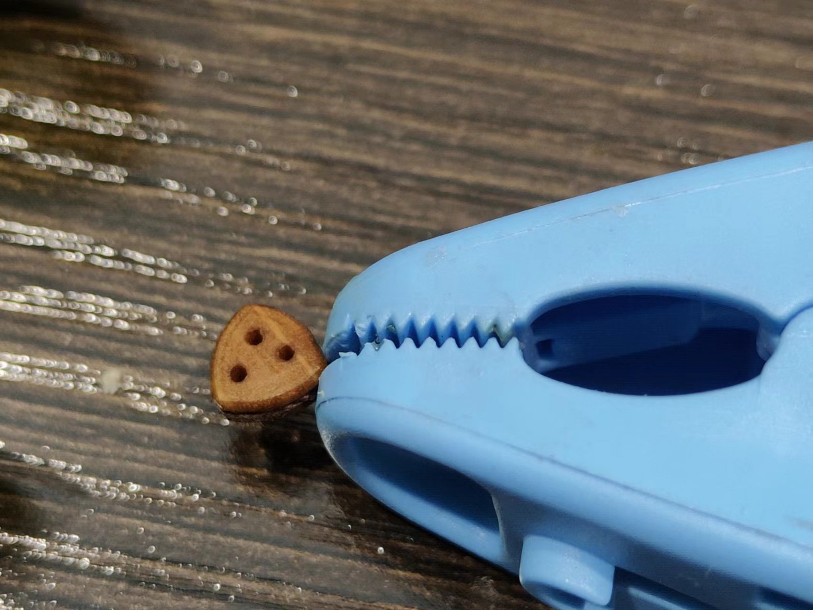

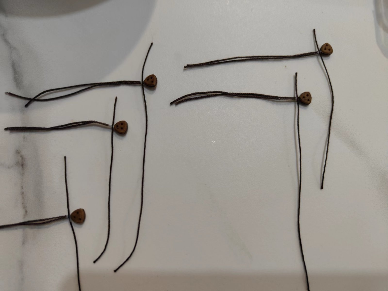

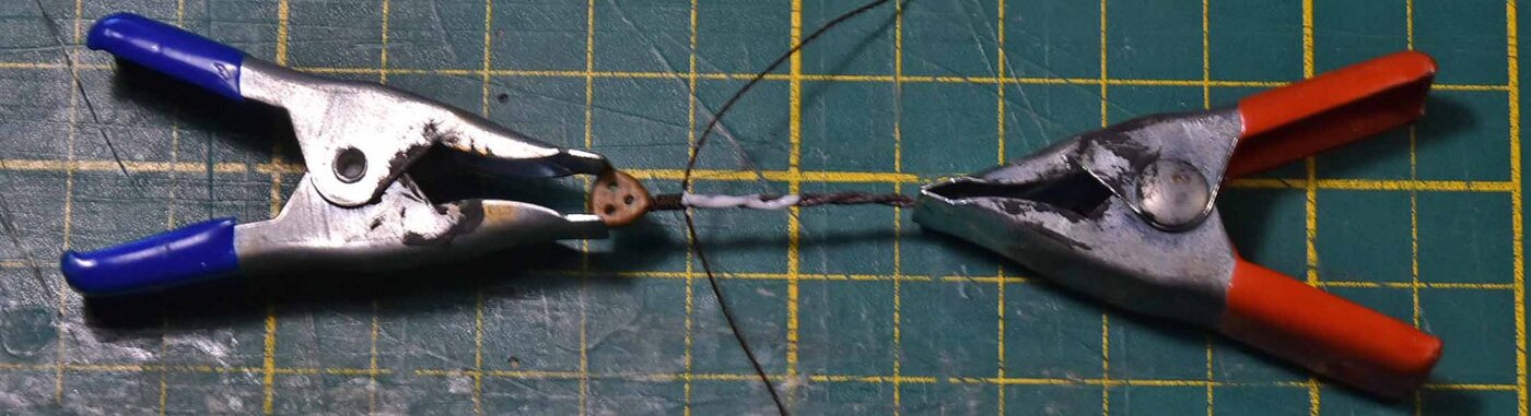

Instede van de ingeslote messing van de bouwdoos te gebruikt, gebruikt Piet 0.5mm touw wat om de jufferblok vasgelijm word en dan afgebind word met 0.3mm bruin touw.
Dit het beteken dat ik weer mijn secret weapon moes gebruikt - Admiraal Anna:
De rezultaat lijk dan zo.
De 0.3mm touw wat gebruik word om de juffers te strop word horizontaal vasgelijm op die 0.5mm touw.
Foto: Piet Sanders
Nadat dit gedoen is, word de oortollige touw afgeknipt en met PVA ingesmeer.

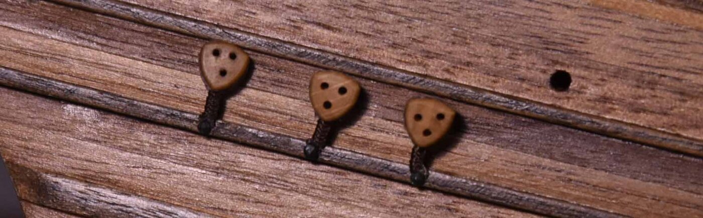

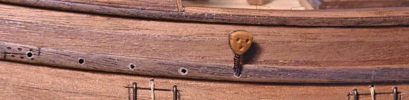

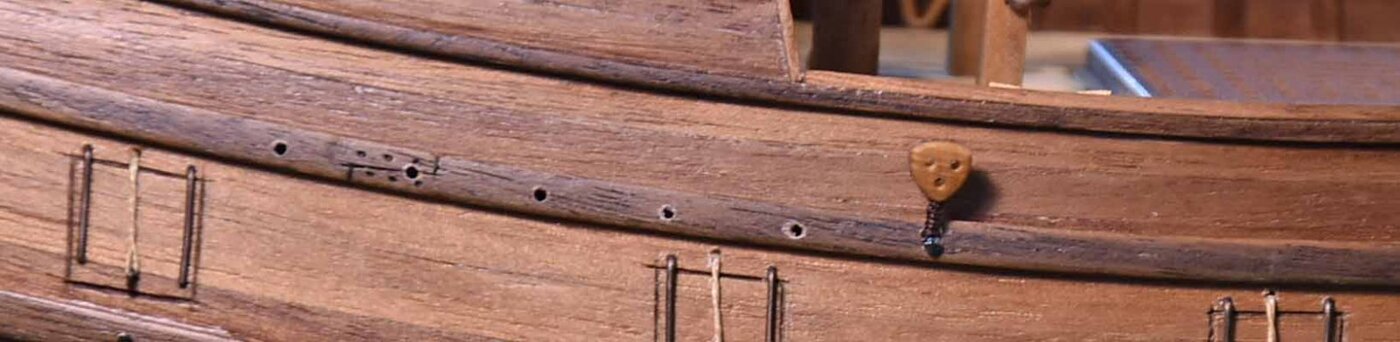

De voltooide juffer met touw word dan in een voorafgeboorde gat geplaast
En met een brass nagel bevestig.
Voltooid, is dit dan hoe de jufferblokken moet lijk!

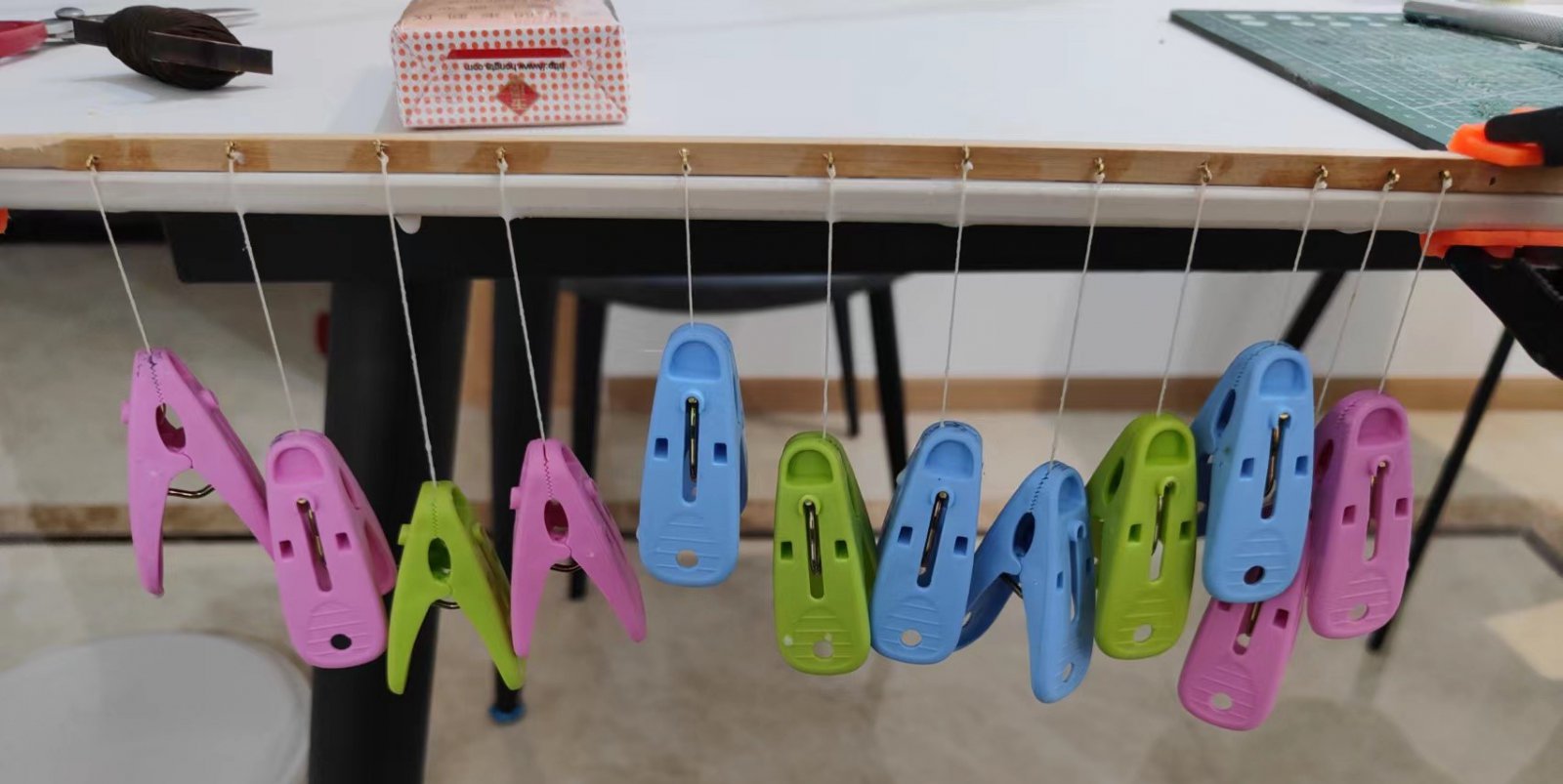

Terwijl ik wacht tot de lijm op de jufferblokken droog raakt, heb ik een begin gemaakt met de touwen wat deel uitmaak van de geschutpoort-deksels.
Waarna ik snel een mal maakte om de haken vast te houden terwijl ik de knopen en touwen bedekte met verdunde PVA. Klemmen werden gebruikt als gewichten, zodat ze recht naar beneden zouden hangen terwijl de lijm droogde. Dit zou resulteren in reguit en rigiede touwen voor mijn geschutpoort-deksels.

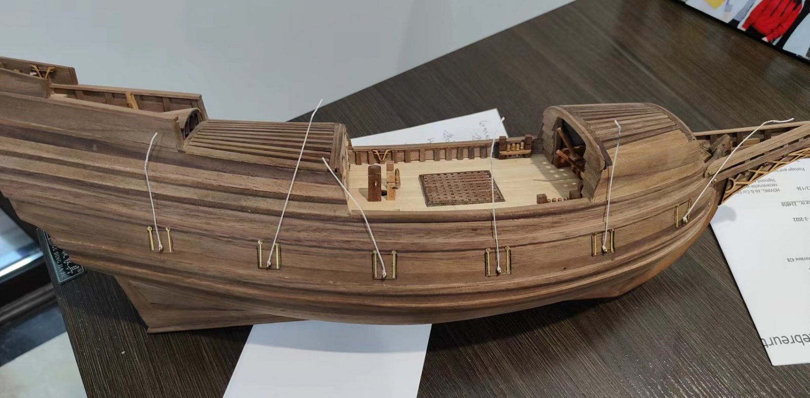

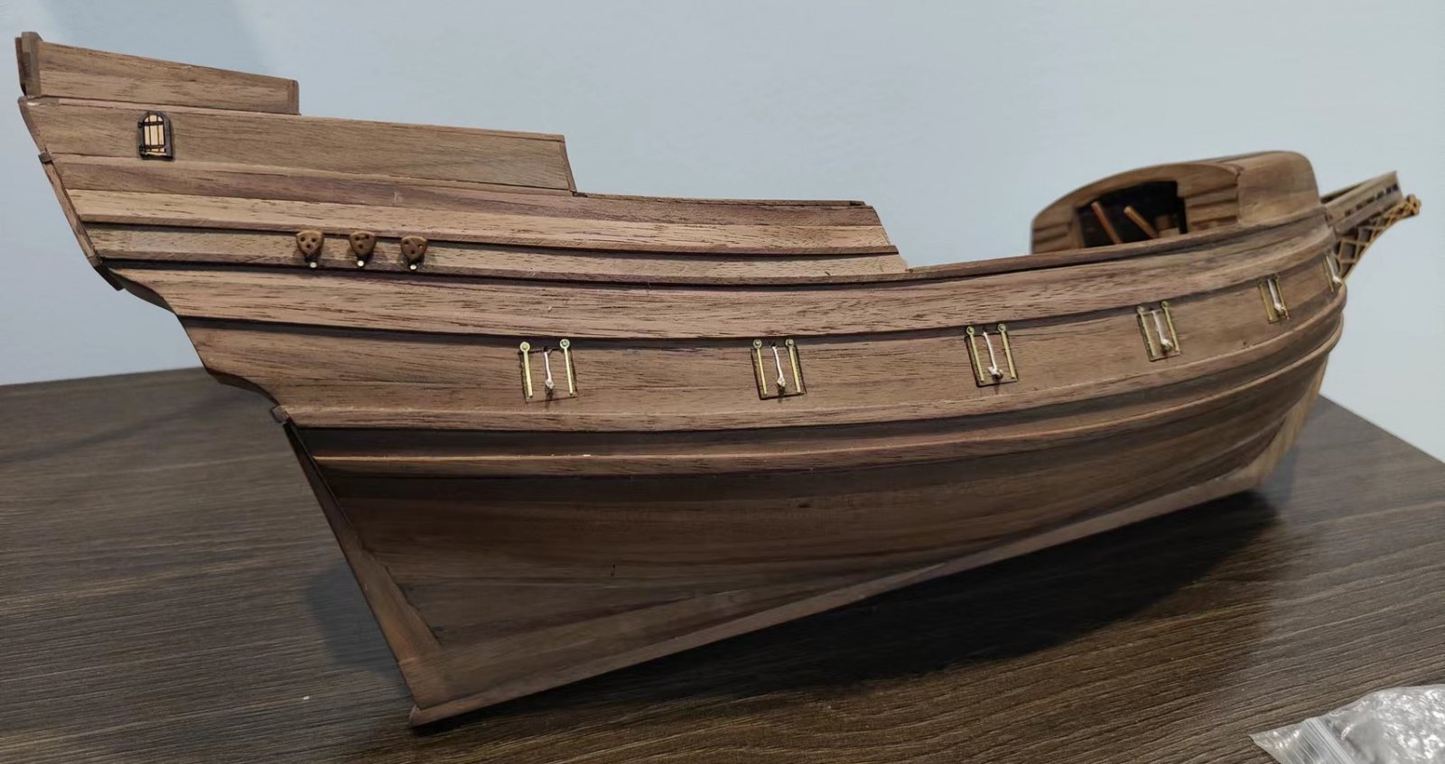

Touwen aan bakboordzijde zijn afgewerkt. Nu moet ik de kanonpoorttouwen van stuurboordzijde doen en tegen die tijd kunnen de juffers uit de klemmen komen.
Met de oogbouten in de geschutpoort-deksels kunt jullie zien hoe stijf de touwen zijn geworden.

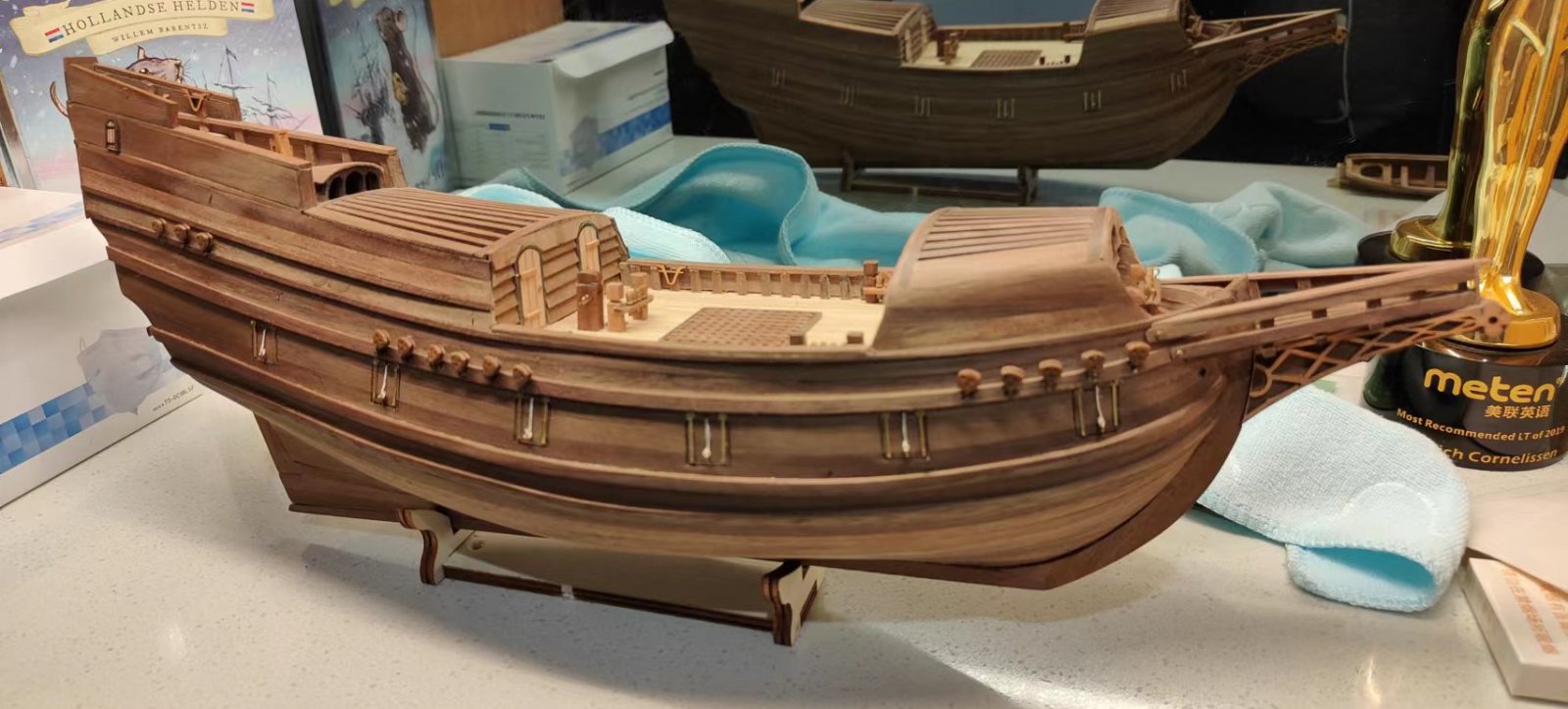

En dan is de touwen aan de stuurboordzijde ook een feit.

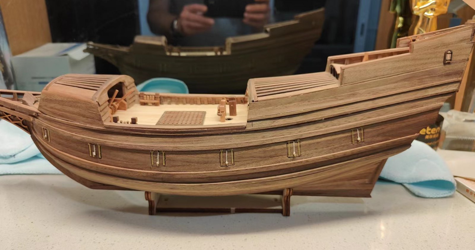

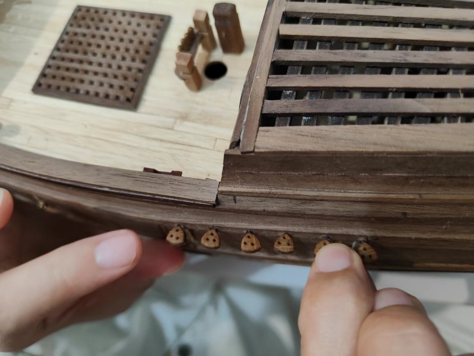

De eerste juffers aan de stuurboordzijde op hul plek.
En de stuurboordzijde voltooid. Nauw word de hele proses weer aan de bakboordzijde herhaald.
Admiraal Anna maakt zeker dat haar juffers net reg zit! :)
Daarmee is alle jufferblokken voltooid en op hul plek.
Ter opzomming, ik ben heel tevrede met de resultaat. De rest van het weekend zal ik de admiraal verwennen en dan volgende week (als de tijd het toelaat) begin met de masten.
